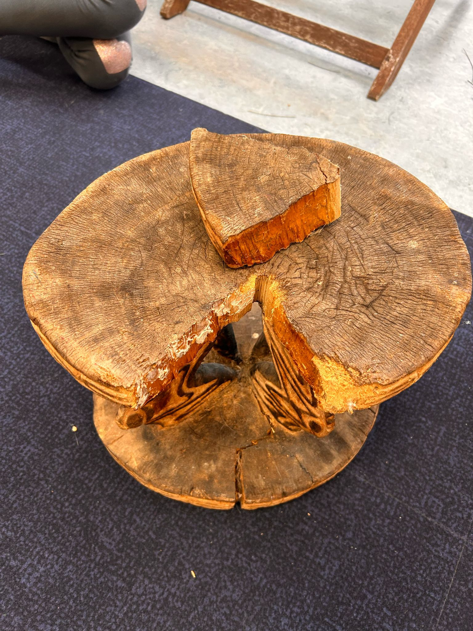

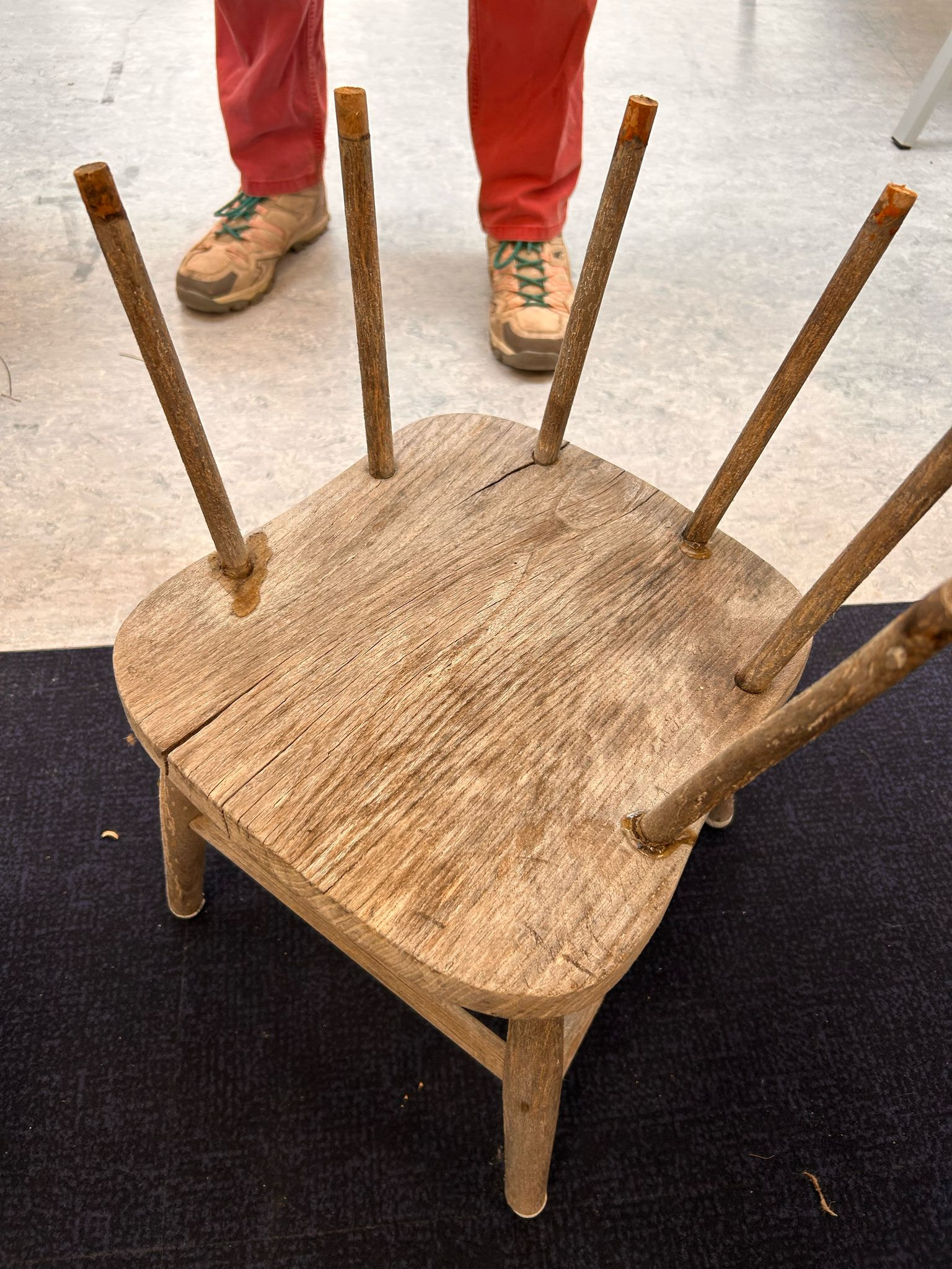

A while ago a lady brought these two items into the Crieff Repair Hub for repair.
I have them in my workshop at home where I am converting the child’s chair to a stool and attempting to repair the second from Papua-New Guinea. Current progress below.
Nice work. Not being a wood person, it feels like that second one would not have been fixable - how did you go about it?
I first ran wood glue along the broken surfaces after cleaning off the old glue and clamped it into place with multiple clamps (I should have taken pictures of this). A day later I removed the clamps, turned it upside down and drilled and screwed the piece in place, from the underside, at an angle in both directions to strengthen the repair. Then I added filler over a few days.

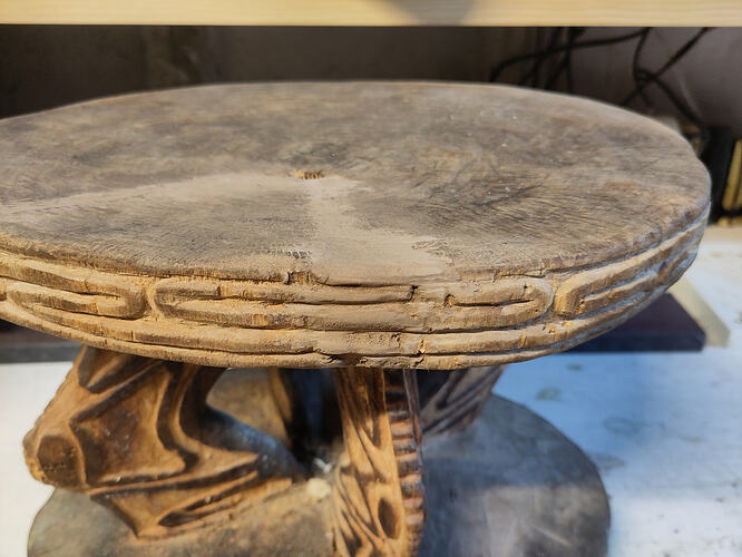

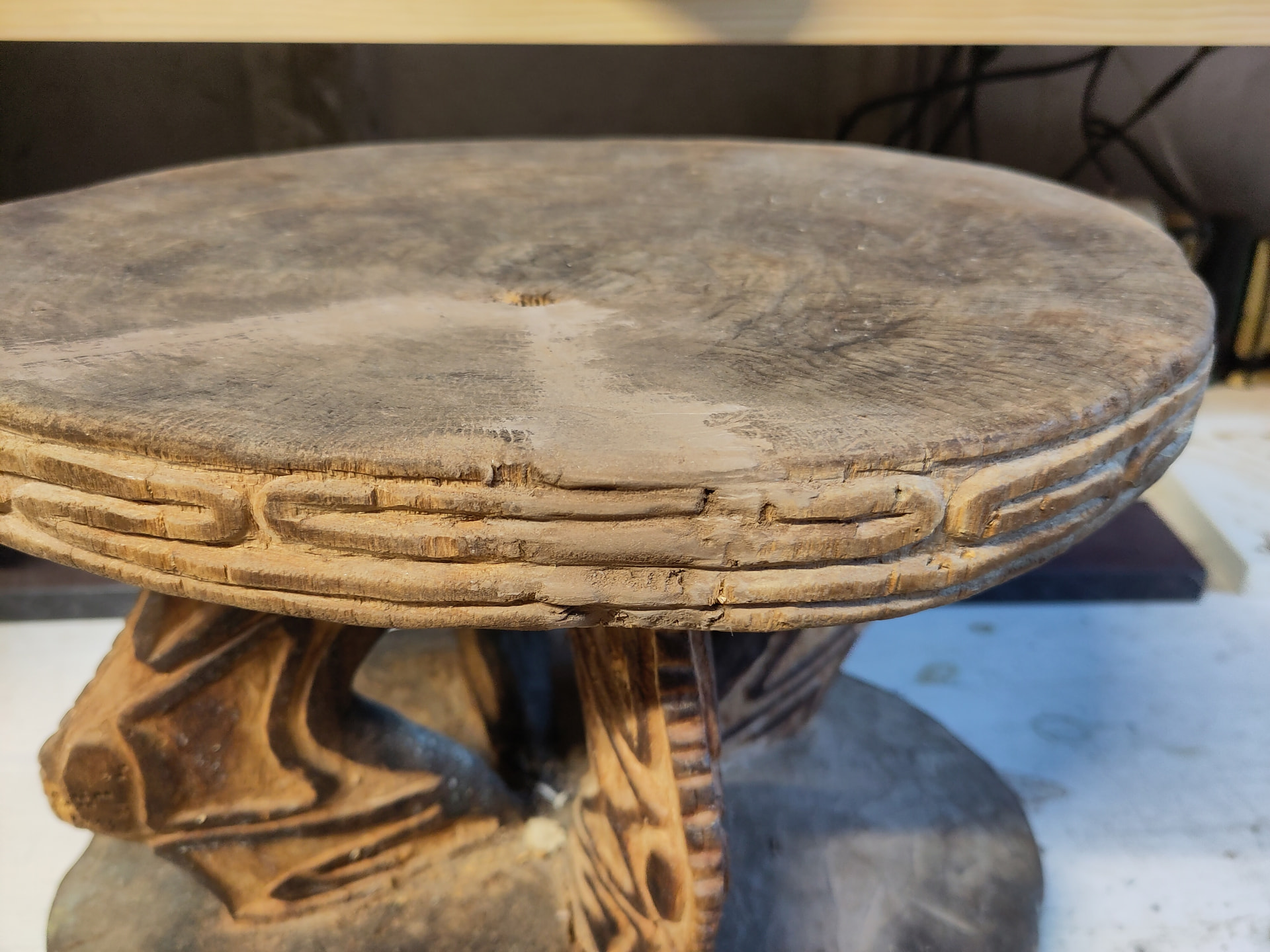

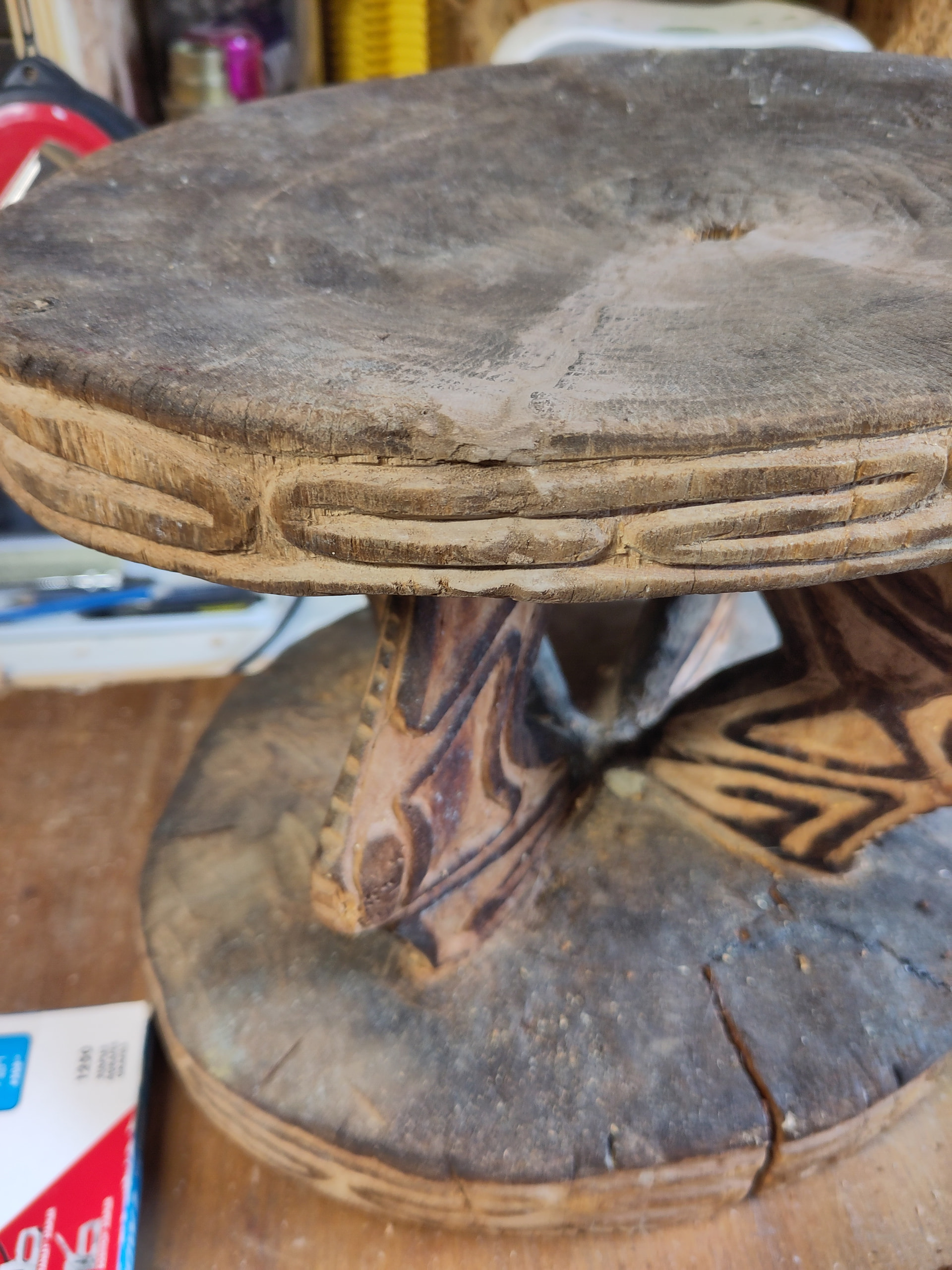

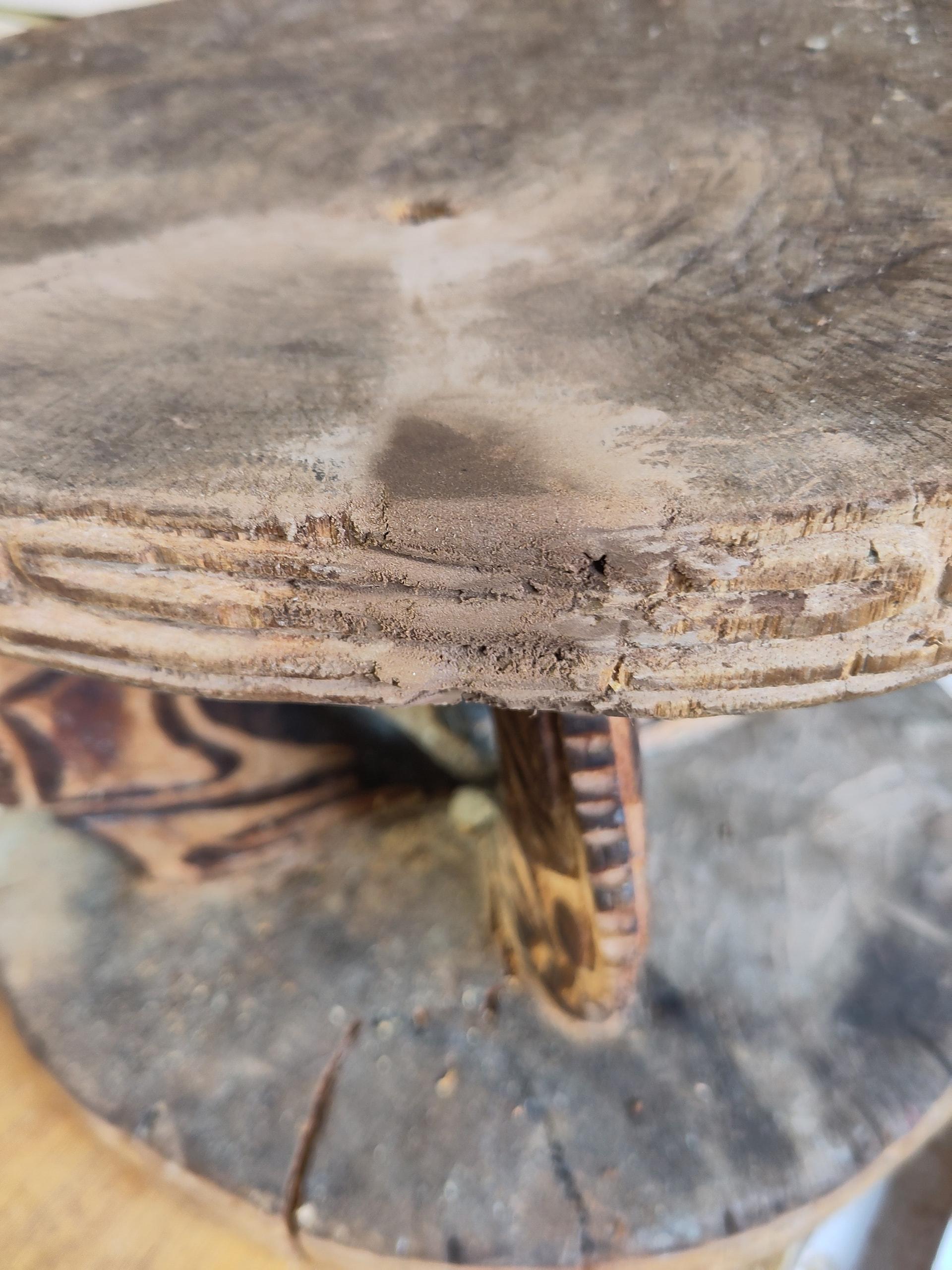

The stool is slowly coming together. The filler has dried on one join completely and I have sanded down and I’m happy with the repair. The other join had a much larger gap and has required much more filler and is therefore drying much more slowly. Here are pictures of both joins as they stand now.
If you can salvage some sawdust from the table/item then this makes for a good colour match when making up the filler for the void. Looks like a great repair. I wouldn’t have had the confidence to repair that.

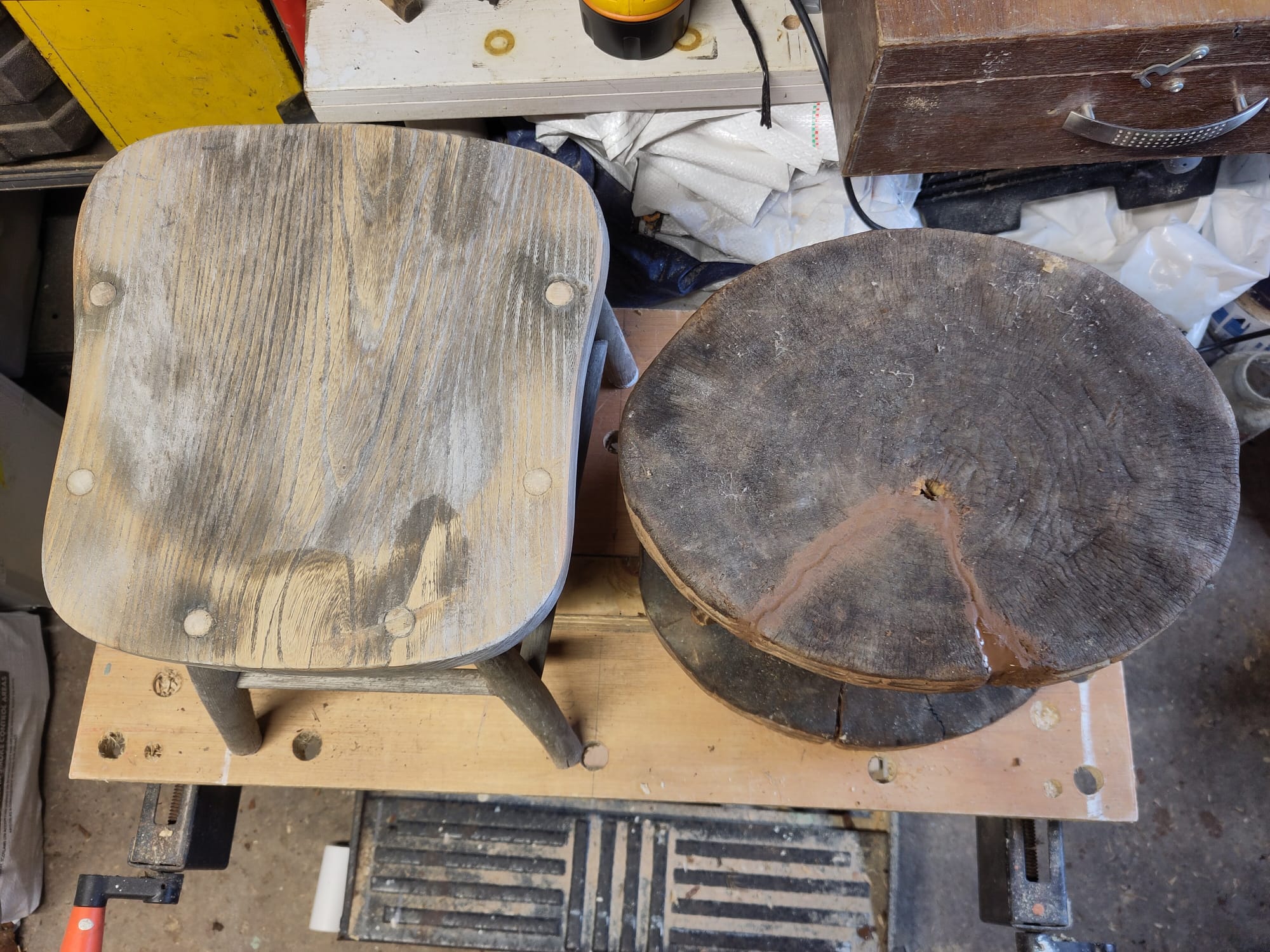

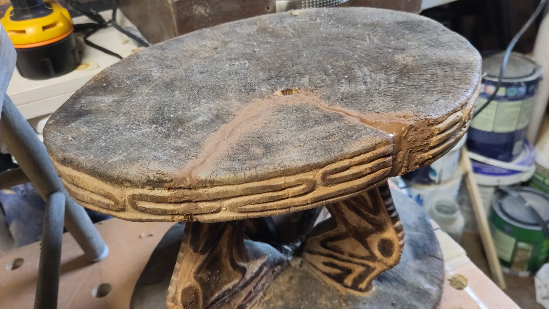

Thanks Alan. That’s what I did with the other stool, mixed sawdust and wood glue and it filled the cracks a treat. Not enough sawdust to be had from this one so filler it was. Here’s what it’s looking like now.
