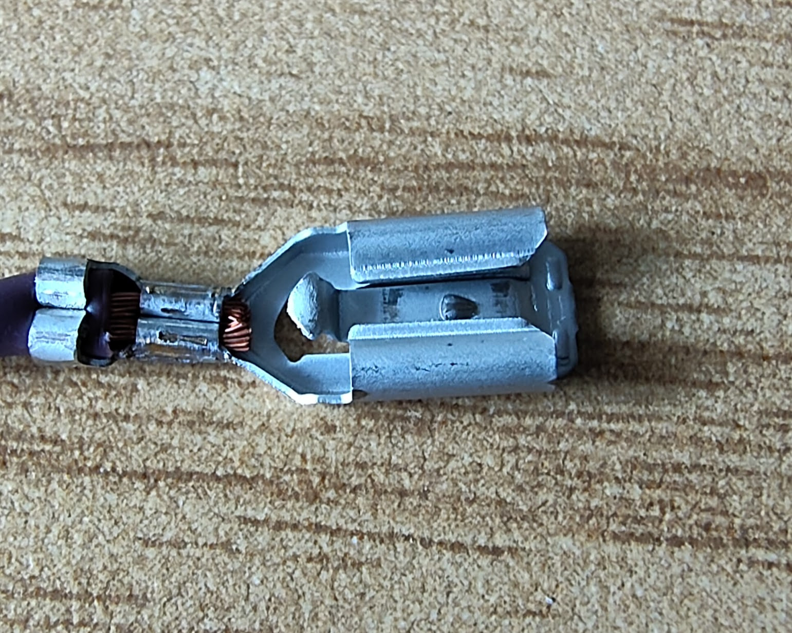

Anyway, as part of that repair, I found that it used this design of spade connector:
I’ve seen the spade connectors with the retention bump before, but this one is more of a barb and there’s a lever to allow it to be released. Not seen these before, but definitely a nice design.
Appear to be these ones or very similar:
https://www.amazon.co.uk/Heschen-female-terminals-connector-insulated/dp/B07MHC5JCH/ref=asc_df_B07MHC5JCH
No, I never seen one like that either. Not sure whether it’s mission critical to replace it with an exact replacement, but looks like you’ve found it.
Yeah, decided it wasn’t super critical and used a more standard one. Though if I ever run out of the supply of connectors I have, I’ll consider them as it seems like a really good idea.
Good find. So many different sizes and shapes. FastON are another brand from TE.com - their catalogue is here. https://www.te.com/en/products/brands/faston.html?tab=pgp-story
