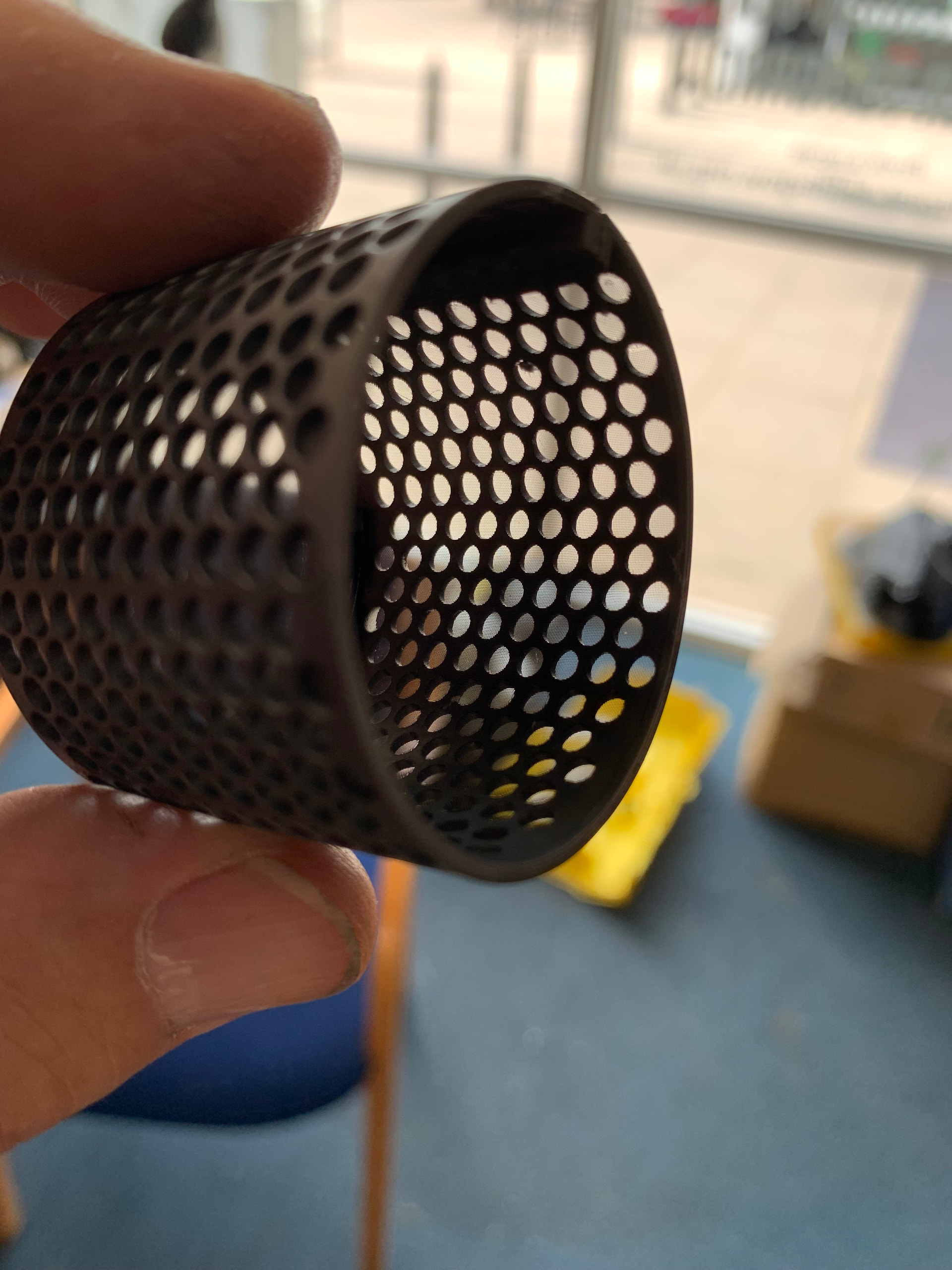

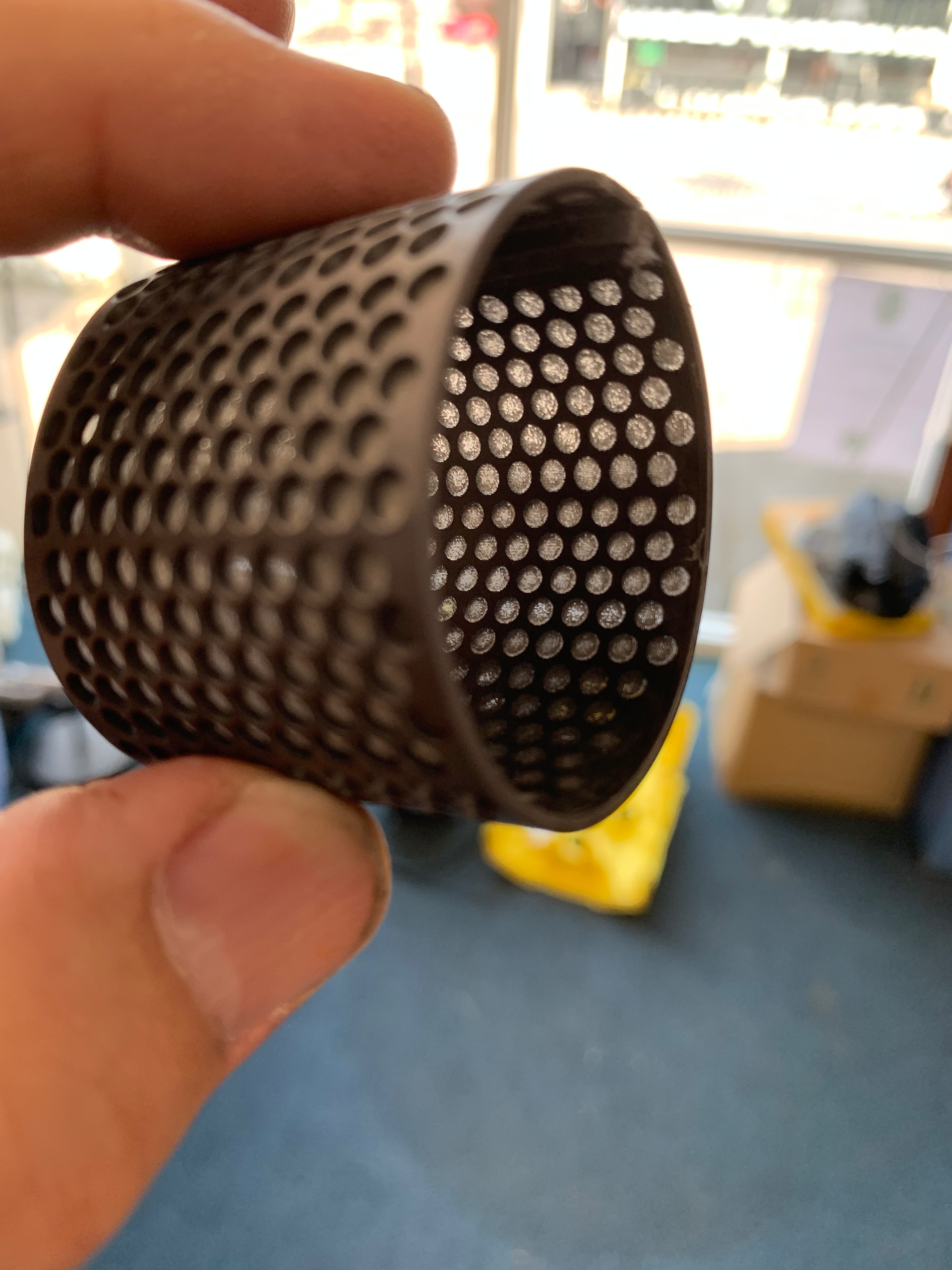

Here’s a before and after photo to show what a small amount of dust does. This is enough to stop it working.
