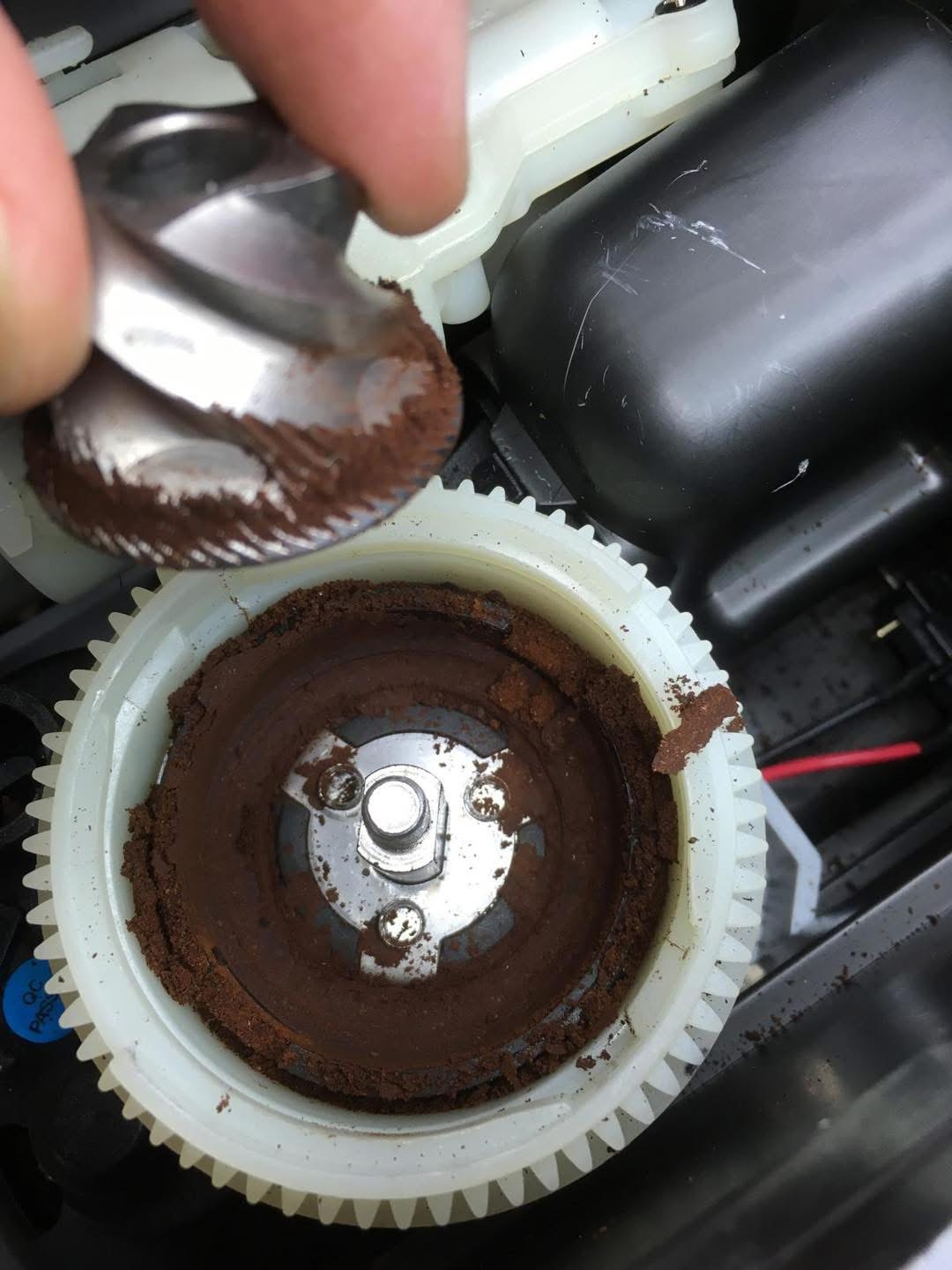

Just finished yet another Delonghi branded bean to cup coffee machine. This one (Magnifica S) was clogged at the grinder and not letting anything through. Customer just sees read light and no coffee. We’ve had a few of these and the manual says clean it, but the customer would need to know how to take off the rear, sides and top cover, then strip down the grinder which has a reverse thread screw, not loose the ball bearings or springs and then put it all back together without missing anything, risking an electric shock, or moving the mechanism out of calibration.
Other machines we have repaired have had worn o-rings (first cup of coffee works but second doesn’t), split plastic (letting water pour over electrics) and not into the mug and the internet also is full of videos of people trying to fix or clean them because they seem overly complex and prone to failure.
Note. Other brands are available!
Repair is possible and parts are too, but what an over-design for a cuppa.
Sorry wrong photo of bean grinder. Similar problem.

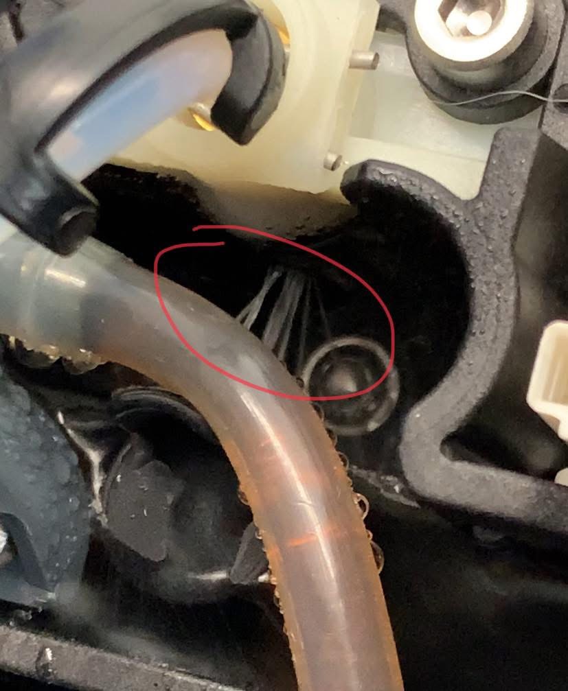

Continuing to investigate. Looks like the motor is stuck and needs brushes sorted along with bearings checked. YT videos can be very beneficial sometimes.
Sorted. Motor needed a clean, pump then started to leak and needed reassembled and cleaned. Nice solid pucks of coffee coming out and reasonable coffee. Onwards to the next one.
