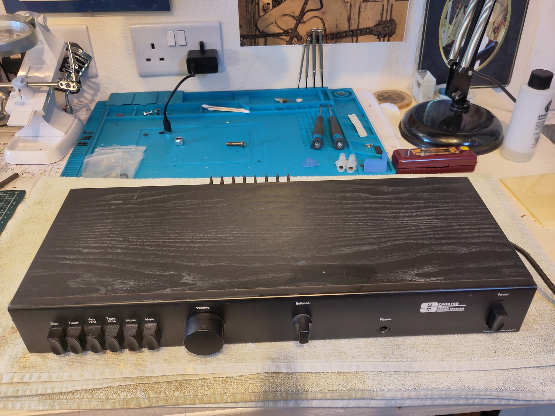

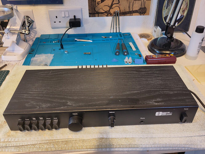

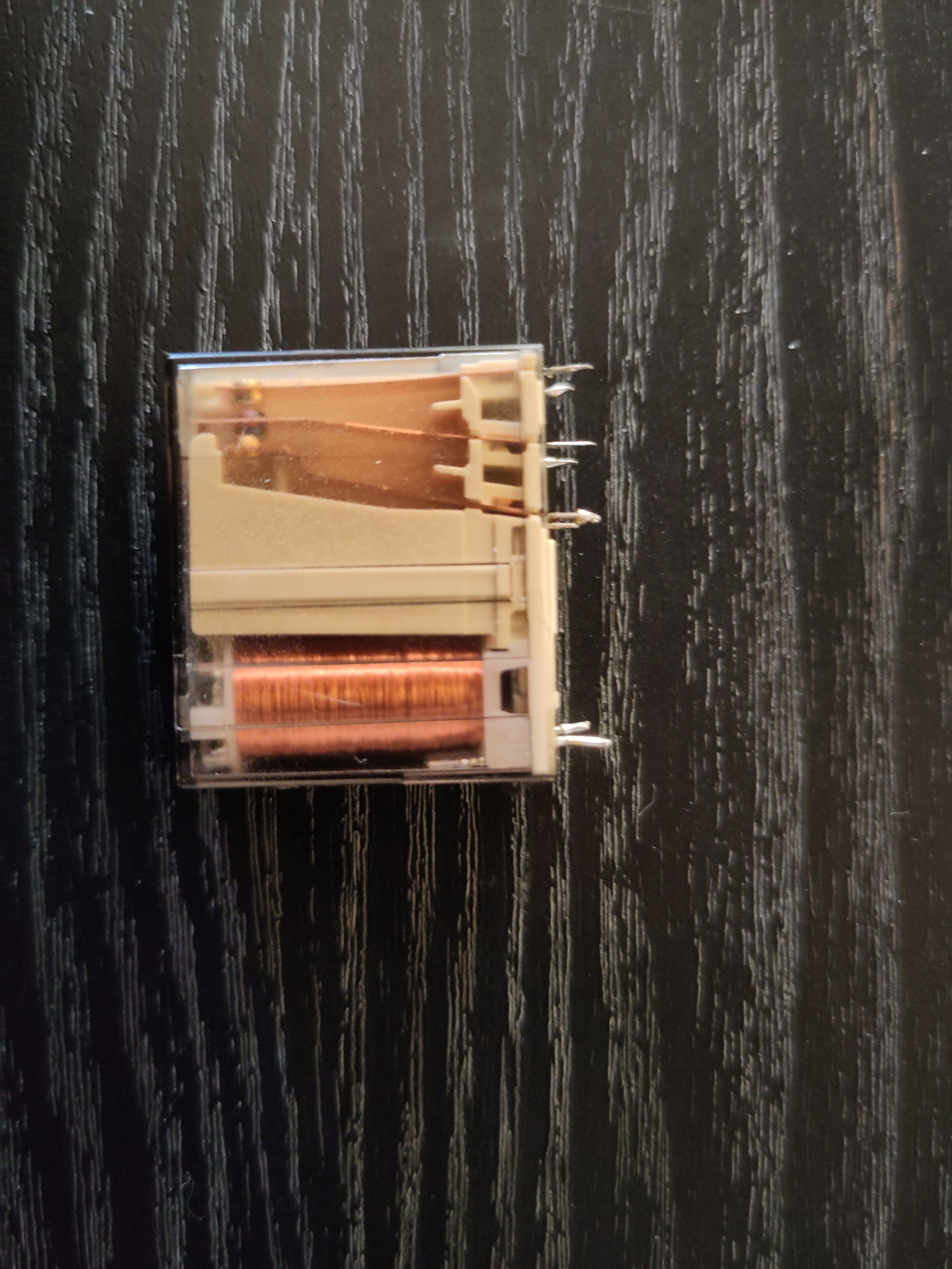

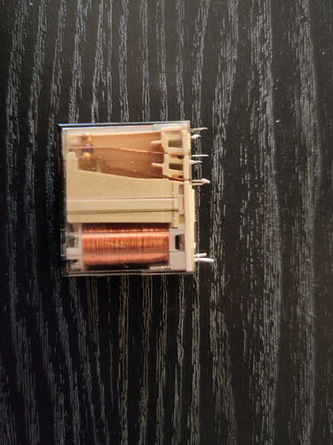

Below is my Creek CAS4140 Amp that I purchased in 1988. Over the last couple of years the sound has been intermittently cutting out on one channel randomly. I contacted Creek and after an email exchange with Mike Creek himself he suggested that the fault was likely to be with the speaker relay and to prove it by tapping the relay while playing music. This proved to be the case with the sound coming and going as I tapped it. For the cost of £10 Creek have sent me a replacement relay. So one of my jobs this week is to unsolder the old relay and replace it. I’ll let you know how it goes.

Relay changed and I’ve been testing the amp for a couple of hours now with no problems. Hopefully it will be good for another 38 years (which is probably longer than I will last)!
