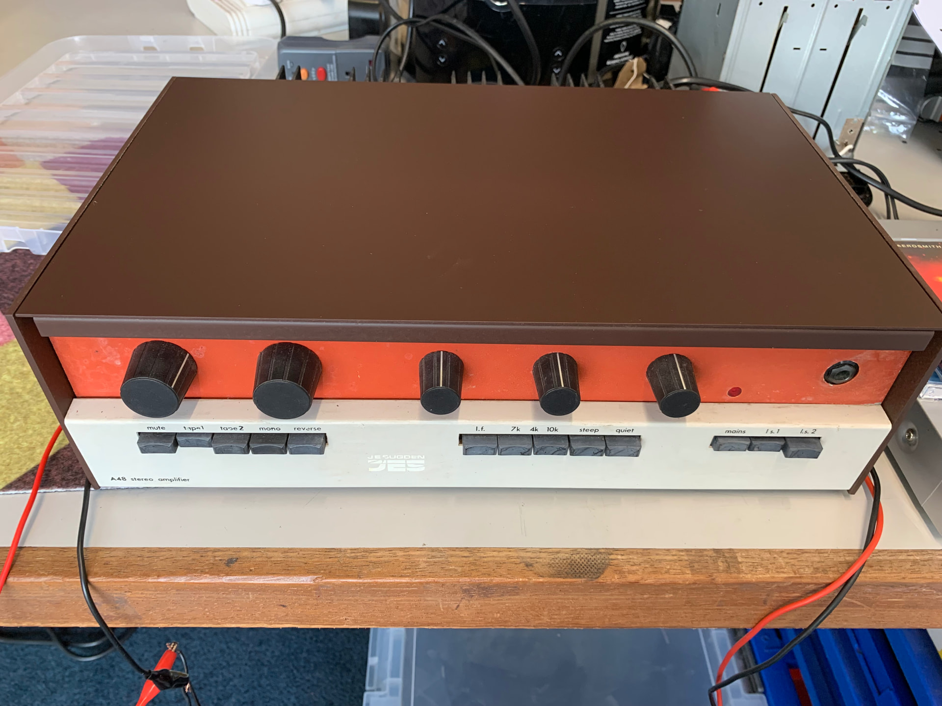

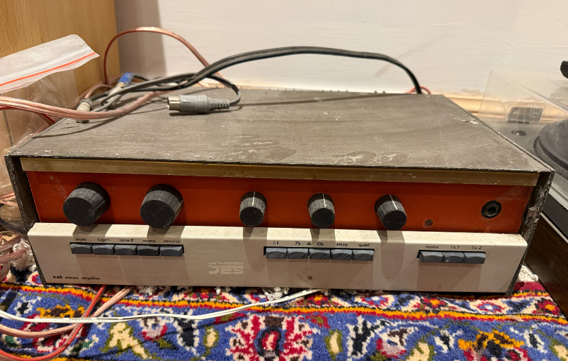

It’s a Sugden A48 which came in along with an old Pioneer Turntable. Both needing some tlc. The amp was first powered on with isolation transformer, dim bulb tester and Variac to ensure we didn’t have a short circuit or appliance that couldn’t cope with 240v AC after years of being in an attic unused. Next we checked the dc voltage on the speaker outputs to ensure we were not going to destroy any speakers fitted. Then the covers came off, caps were checked to be discharged and a new power cable was fitted.
The cover has been painted with a paintbrush with no primer coat and was flaking off so that needed fixed too.
So far we’ve tested the amp with a signal generator and oscilloscope and run for a short while with a cd player hooked to the tape input. Next will be phono circuit once we get the turntable working.
