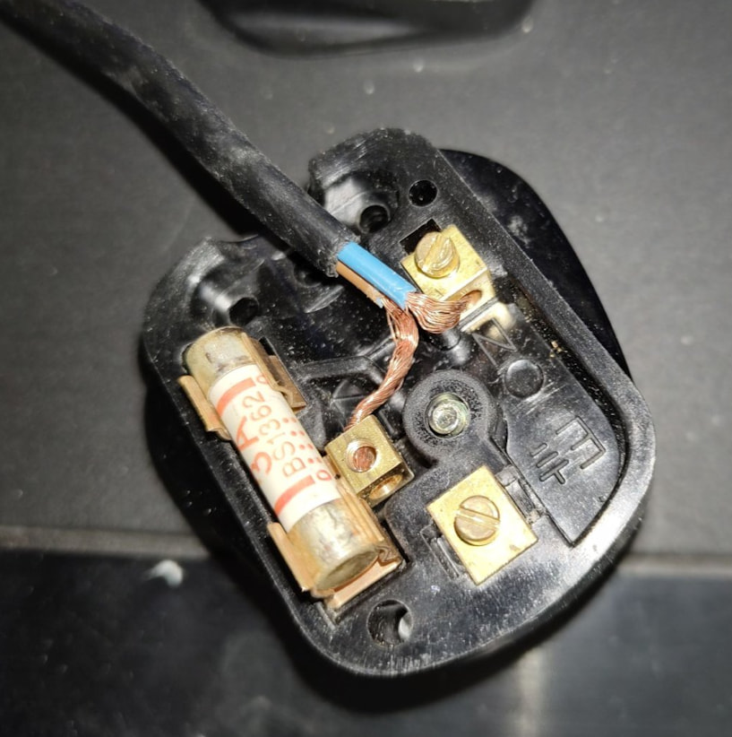

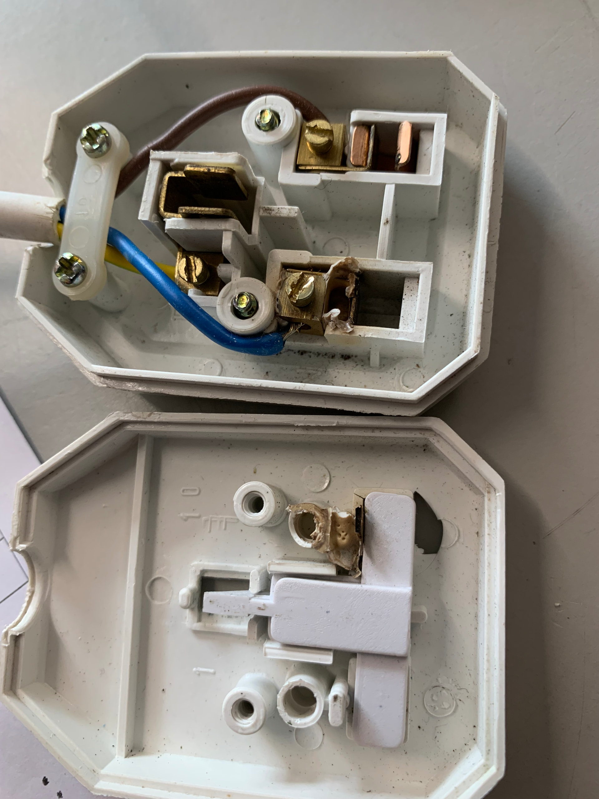

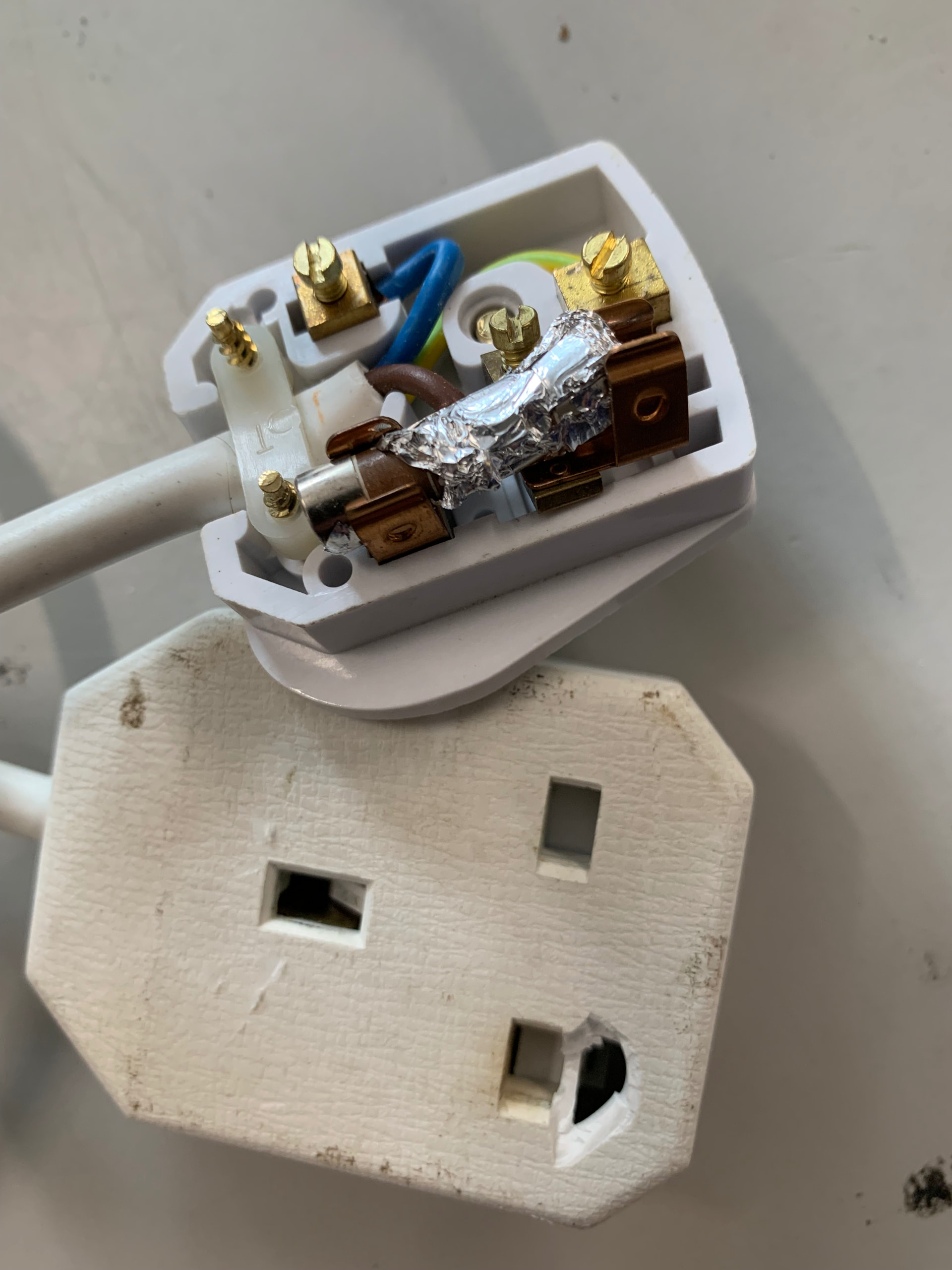

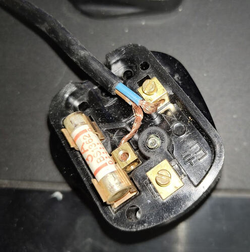

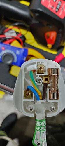

We had a nasty plug recently, someone took a photo of it.
I’m surprised I haven’t seen more Temu / Aliexpress Chinese death traps to be honest.

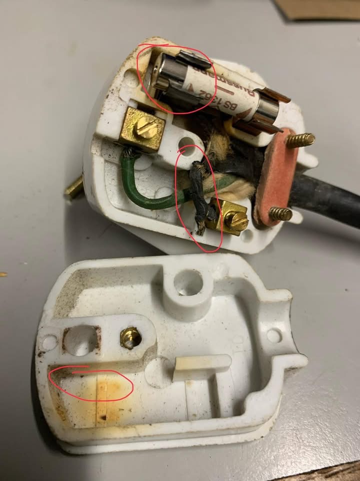

Lifted from another forum… this is a tape deck a bloke bought off eBay.
can you count the number of problems here?

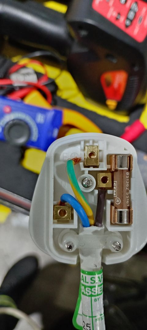

Received this week. iron and extension lead. Customer said “my iron isn’t working”.
I wonder why. Please please make sure you don’t assume the PAT tester is enough. Open up plugs and sockets. Find these horrors and fix them asap.
