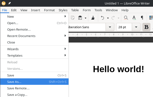

One-time save
If you just want to save a single document, then you want to use Save As rather than Save:

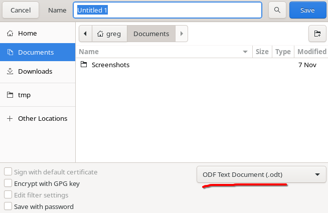

You can then select the file format in the selector at the bottom:

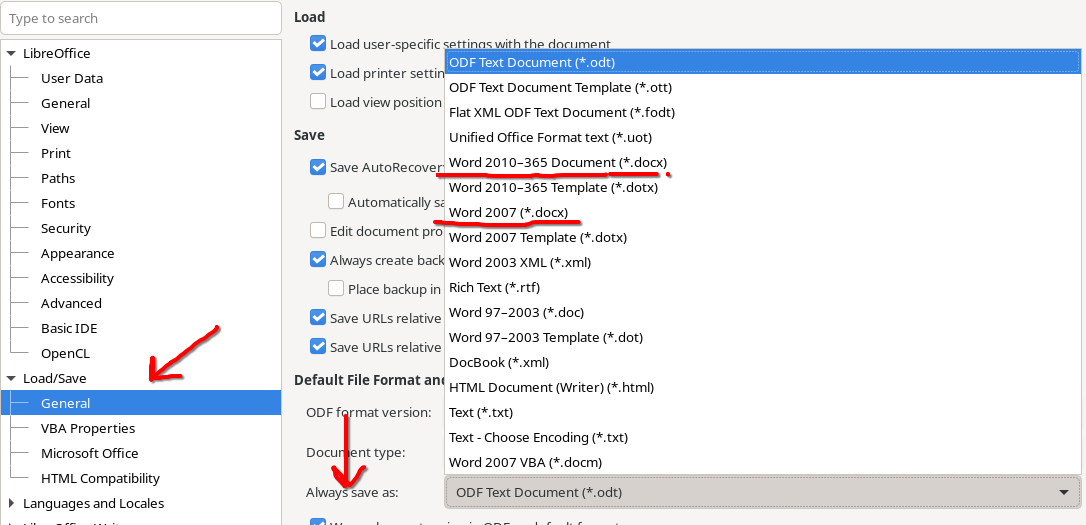

If you want to save every file as MS-Office by default, then, you can alter your options (the very last item under Tools):
Then you can go to Load/SaveGeneralAlways Save As and select the format you need:
