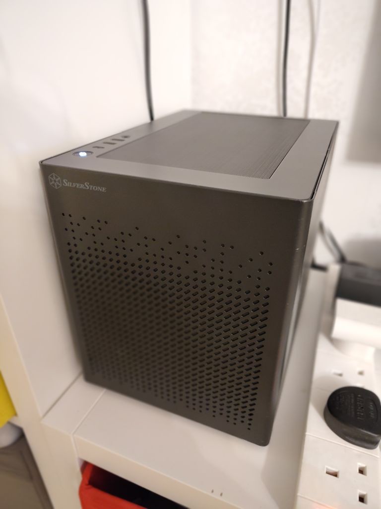

After a few mistakes and a bit of trial and error, this is what I ended up with:
I didn’t take the cheapest route, trying to build the most compact system you can ends up costing a little more, and there was a few things that I wanted to try that I knew would cost me a bit more than strictly necessary.
What I’ve landed on for now is this, mainly bought from eBay:

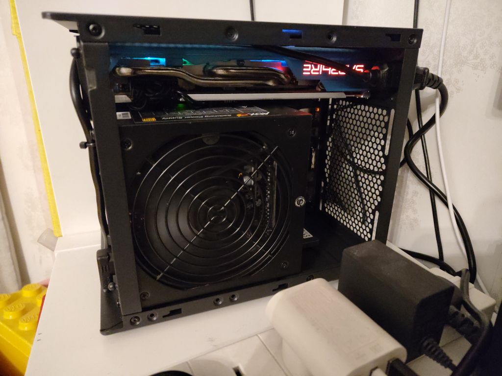

This combination seems to be working reasonably well. The motherboard has a few issues around suspend and resume that I’ve needed to work around. I was hoping to use a spare 460W ATX PSU but it turns out the RX 580 graphics cards can have a very “spiky” power draw and the one I had wasn’t able to power it well enough, leading to random reboots.

  • Graphics cards are stupidly large these days (even the relatively old ones). They also draw a lot of power.
  • The 8 & 6 pin power plugs on PSUs are probably designed for connecting to the motherboard not a graphics card. This results in adapters being needed in a lot of cases.
  • Modular PSUs (like the one I decided to try as I’d never had one) probably minimise the number of unused power cables and adaptors you need to manage, but the cables you do need seem to almost take up more room than the “fixed” cable power supplies and because they are connected all over 1 side of the PSU rather than all coming out in one relatively small clump, they’re way harder to cable manage.
