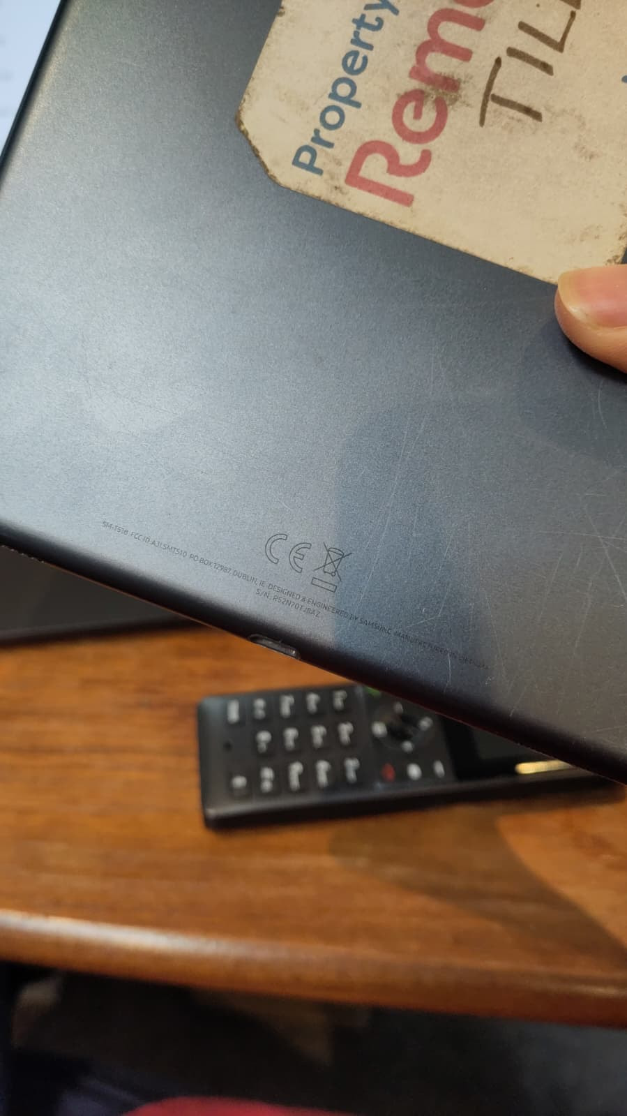

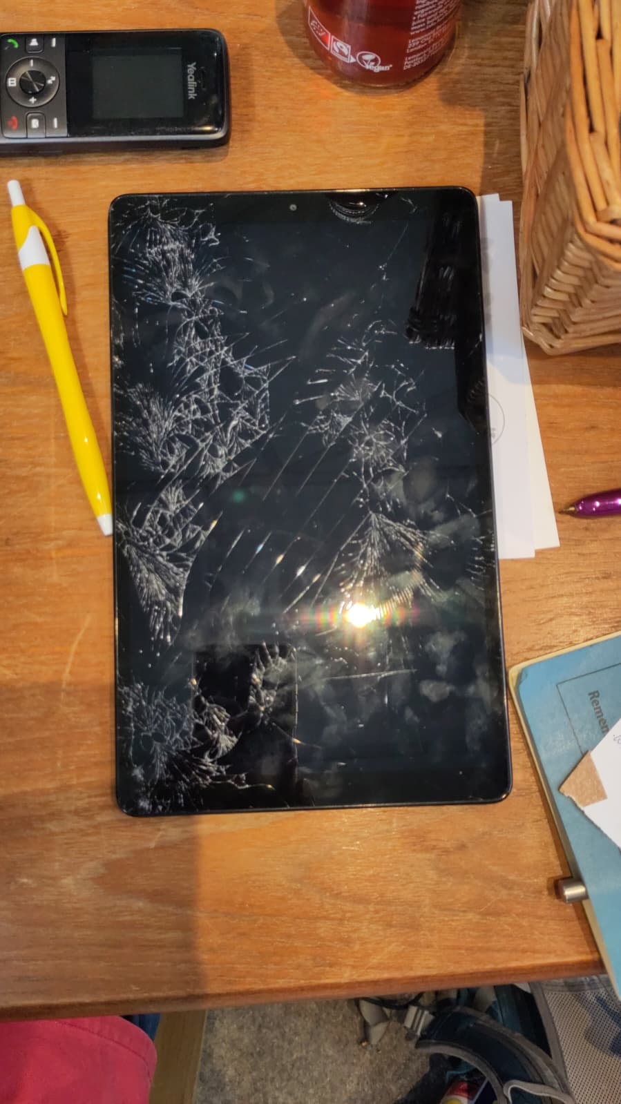

Hello, These are the follow up photos of the broken samsung tablet - screen fix - i emailed about. Samsung SM-T510
Wow, you weren’t kidding about the screen.
@martyn I’m guessing this will be fiddly?
@mcFisher Does the screen stay black or is clearly damaged when turned on, or does the screen show up ok and just the touch element of the screen that’s broken?
@martyn I’ve just heard from lily.. the screen lights up and works fine, its just a bit risky because of the broken glass pieces!
In that case, we might be able to replace just the front glass. I’ll have to take a look into that.
Relacing the glass alone looks like a way more complicated procedure and the videos I skimmed on YouTube seemed to be using some fairly specific equipment. The price between the glass/touch panel (~Ā£20) and a complete screen assembly (~Ā£30) doesn’t really justify the extra effort to be honest.
