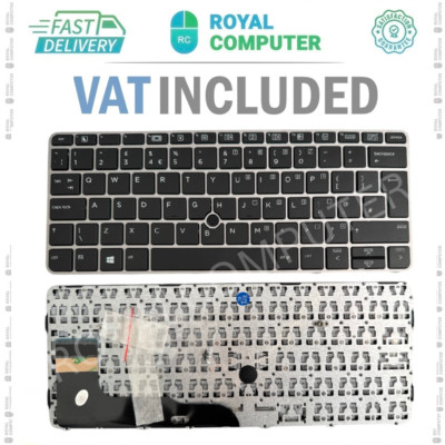

Fair enough. Something like this?
Seems like a reasonable price for a fix… I can order that in time for next week :slight_smile:
I’d pop the existing keyboard and compare the underside, check for model numbers etc.
Fair enough. Done, and ordered a matching one, should be here before Sat.
So it turns out that these keyboards seem remarkably hard to get - eventually I went with a vendor that sells re-stickered ones. Looking at the names of the function keys, I think the original may have been Spanish :slight_smile:
